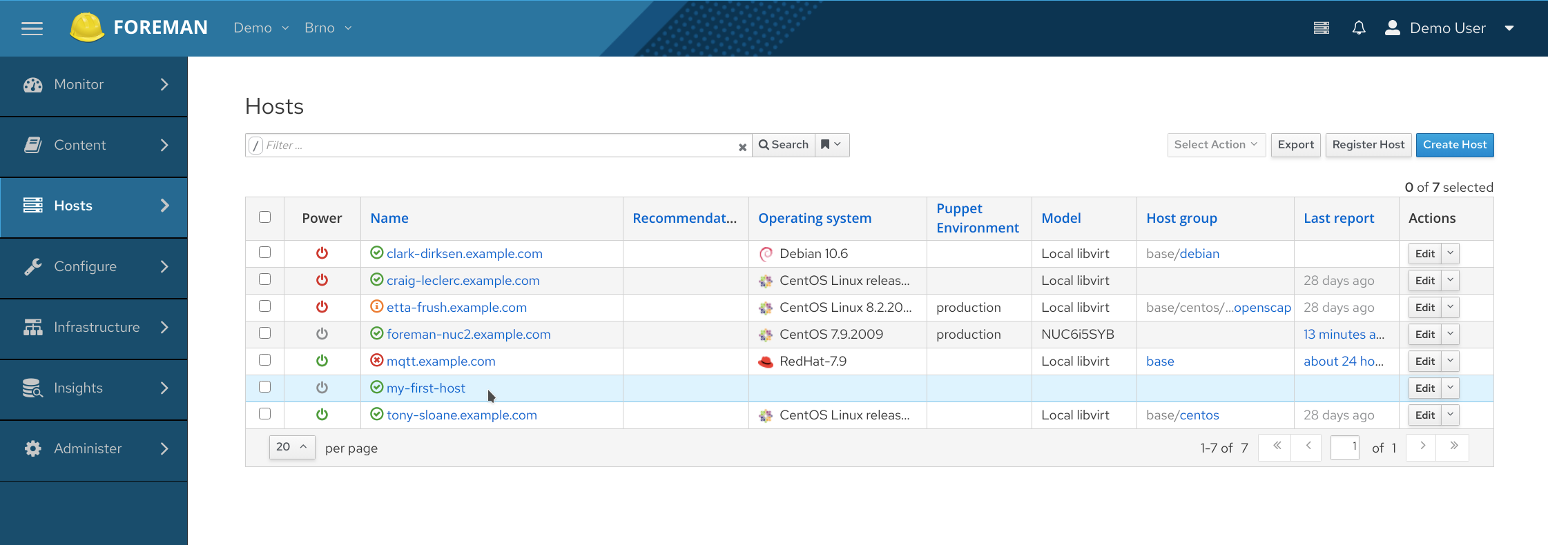

Currently, there’s no way how to manually create unmanaged host easily in Foreman’s Web UI. You can create only the managed host and turn it later to unmanaged. Managed hosts require much more information from user, so that Foreman knows, how to configure external services. Therefore it’s good to start with unmanaged hosts first, unless you plan to provision hosts as the first step.
Once you create the unmanaged host, you can work with it in the UI. Navigate to Hosts -> All Hosts page and see the entry with the name my-first-host. You can click Edit button and fill in more information about the host. Clicking on its name takes you to its detail page.

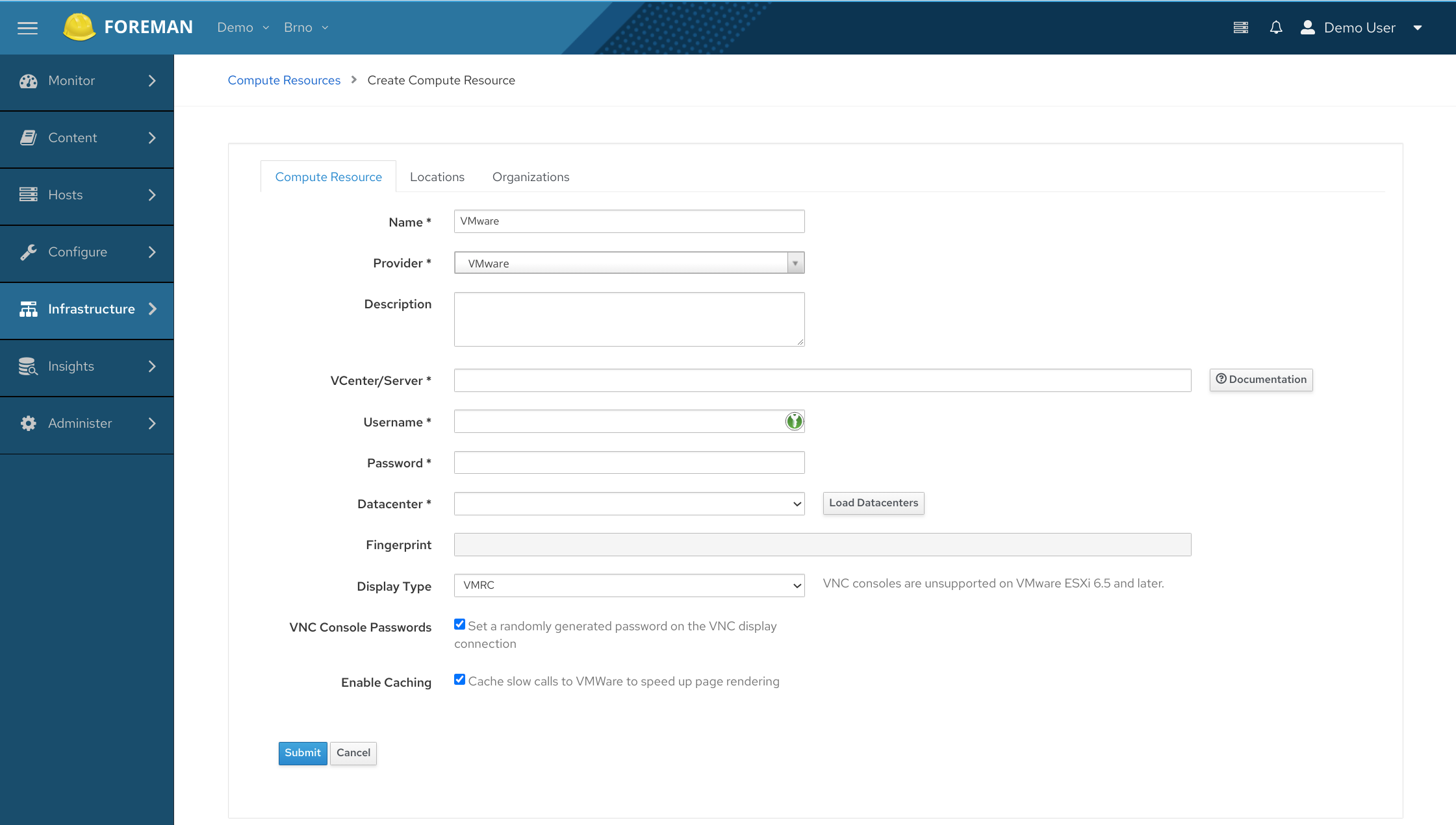

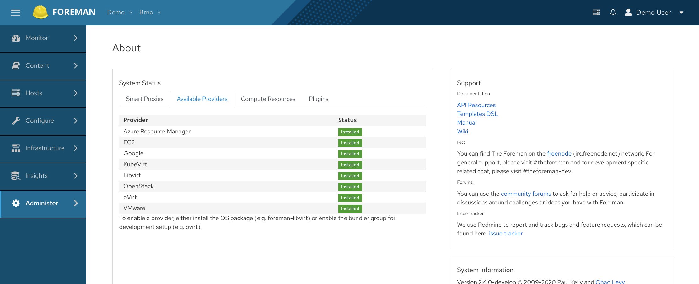

Navigate to Infrastructure -> Compute resources and click Create Compute Resource button. Give it some name and select a provider type. If you don’t see any provider, you need to install some. While some providers are part of Foreman core, we ship them in separate RPM packages, so users can install only those, that are interesting in their environment. In order to see, what providers you have installed, navigate to Administer -> About -> Available Providers.
Here’s a table with installer argument for each core provider
Virtualization Installer argument
Amazon EC2 --enable-foreman-compute-ec2
Google Compute Engine --enable-foreman-compute-gce
Libvirt --enable-foreman-compute-libvirt
openstack --enable-foreman-compute-openstack
oVirt / RHV --enable-foreman-compute-ovirt
VMware --enable-foreman-compute-vmware
To install the support for a particular provider, run the foreman-installer with the appropriate argument, e.g. foreman-installer --enable-foreman-compute-vmware. Multiple providers can be installed at the same time.
After you choose the provider in the compute resource form, some additional fields show up. This is the form specific to the selected provider. Some providers allow to test the connection, which is required to load additional information. The test only verifies the connection can be established but does not necessarily verify, that credentials are correct or the account has all required permissions.
The Organizations and Locations tabs can be ignored for now, but make sure at least one of each is assigned. Most likely you’ll have a single option in both selectors.

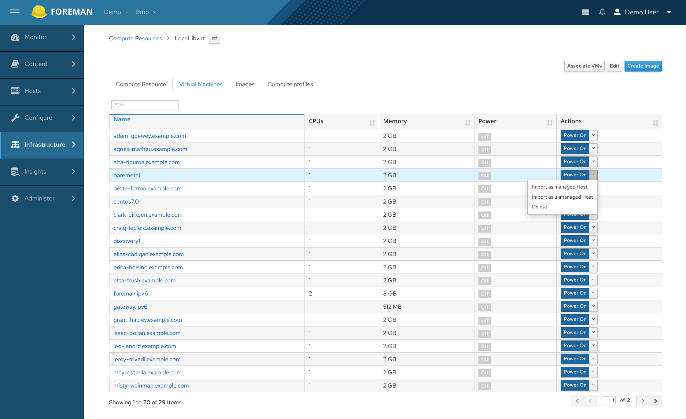

After the compute resource is created, you are redirected to its detail page. Click the Virtual Machines tab to list VMs on this compute resource. You should see some basic information about VMs. Based on provider capabilities, you can power them on and off.
Note the little drop down icon next to Power On and Power Off buttons. This is the multi action button that the Foreman uses in many places. Clicking the down caret will open other actions that can be performed on the item. In this case, there are three more actions, Import as managed Host, Import as unmanaged Host and Delete. Deleting a VM can delete the VM including all hard drives on the compute resource, so be careful with that. This behavior respects the Destroy associated VM on host delete setting, which defaults to No. However if turned to Yes, this can lead to the permanent loss of the data of your VM.
However the import functionality is what we were searching for.
The difference between importing a managed and unmanaged host should be clear at this point. Both actions take you to the Host creation form. The form allows to specify more details about the Host. For unmanaged hosts, all necessary information is already prefilled, so you can go ahead and click the Submit button. The information is fetched from the compute resource, so e.g. RAM amount or network interfaces MAC addresses is correctly set. Provided information differs per compute resource type, e.g. VMware gives us much more information than Openstack.
