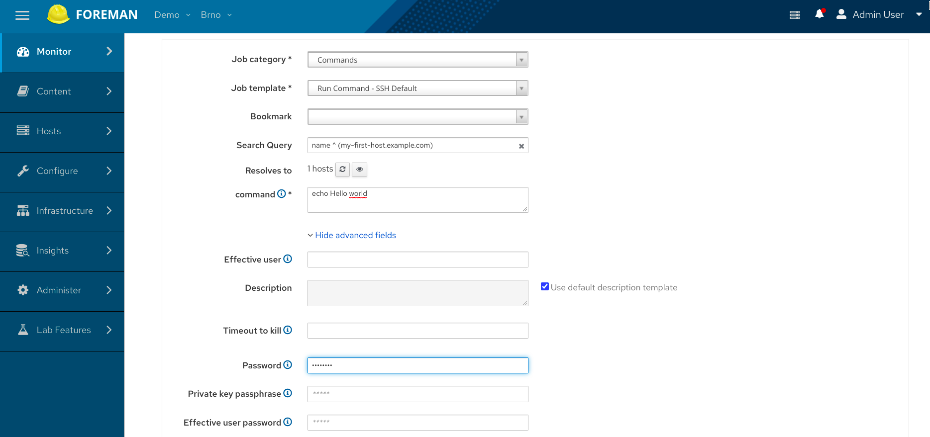

Once the installer finishes the run, you will see the new menu entries in the Foreman instance. Let’s try running a job on some host. Make sure the host is running SSH daemon and Foreman can connect to it. Navigate to an existing host detail page and click the Schedule Remote Job button. Fill in a simple bash command to the command field, e.g. “echo Hello world”. Click Advanced fields and specify the password for the user. The password is stored only for the time it takes to execute the script, then it’s wiped out.

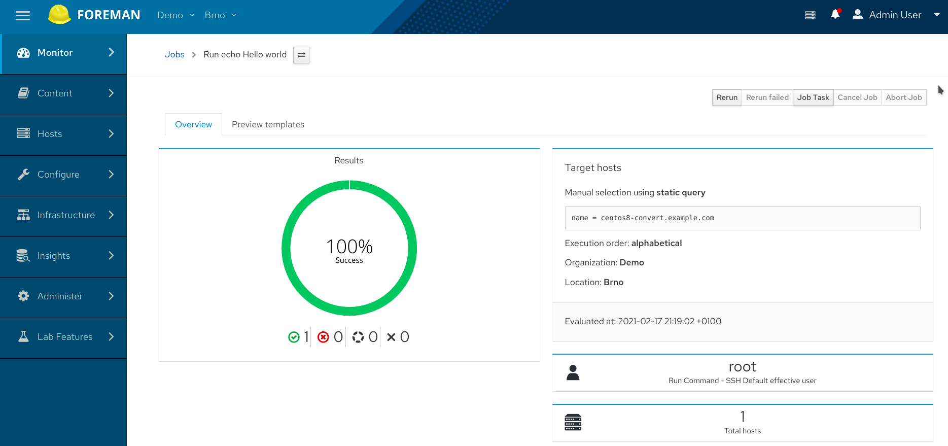

Click the Submit button. The job will get started and, if all works, it should finish successfully, which is indicated by the green chart. You don’t have to reload the page to see the result, it refreshes automatically.

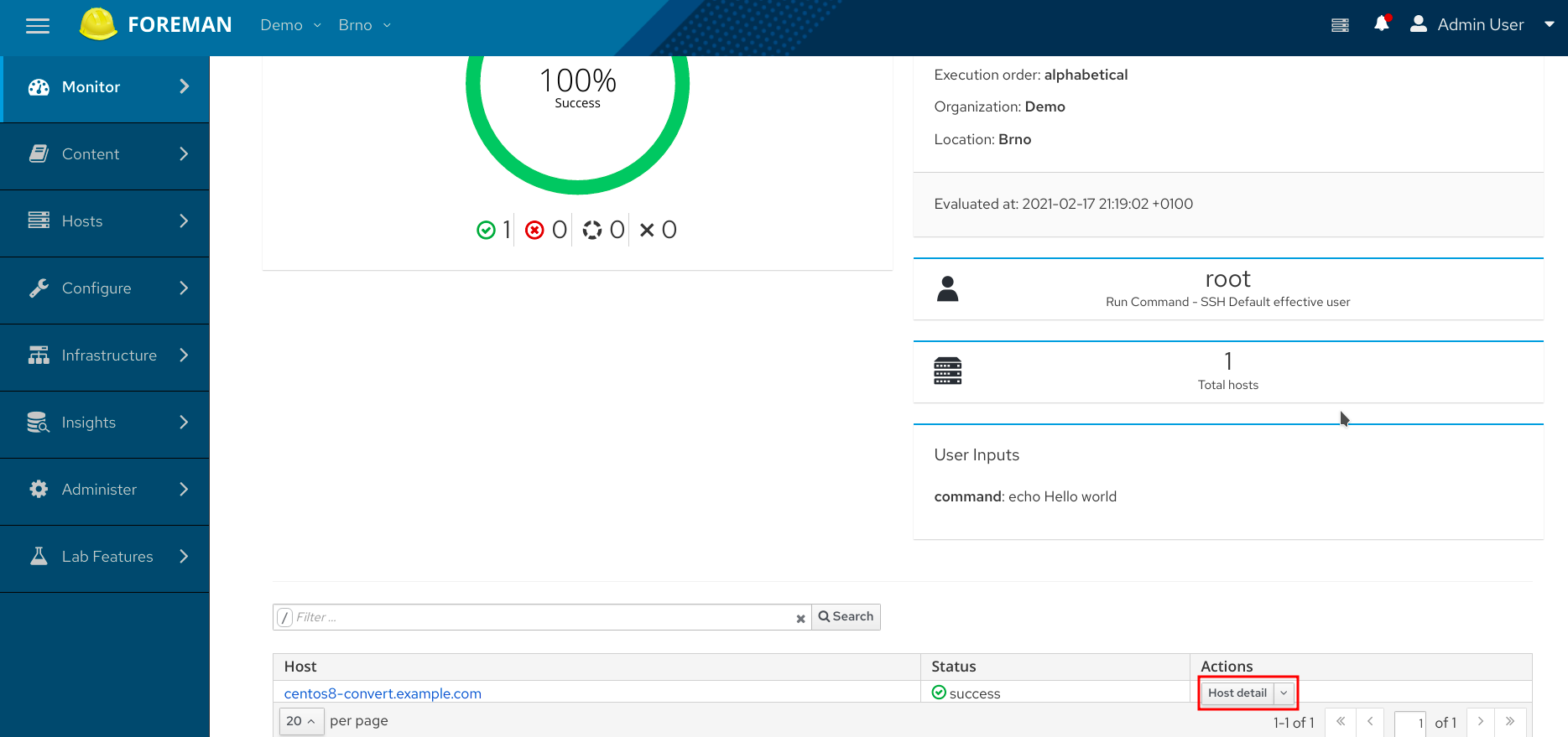

Let’s investigate the output of the job. On the job detail page, click the the host name link in the table at the bottom of the page - you may need to scroll down a bit. You should see “Hello world” which is the STDOUT of the job. The job is considered successful if the connection was established and the job finished with exit status 0. Otherwise it’s considered a failure and you’d see the error in the same place, where you normally see the STDOUT.

It is not practical to specify the SSH password for each job. Especially if you run the job on multiple hosts and they don’t have the same password. The installer generates a SSH key pair on the Foreman Proxy host. You can distribute the generated SSH public key or setup your existing SSH key you already use. The default SSH key pair location is at

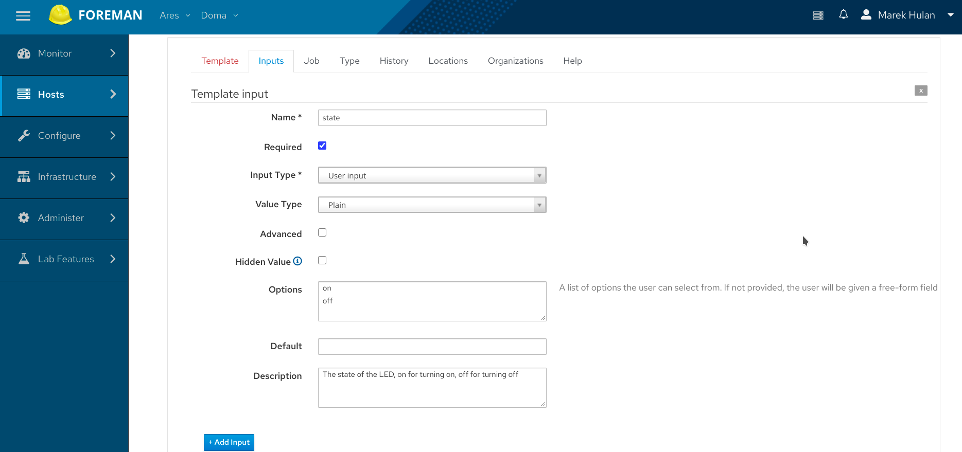

I created a new job template that switches the LED blinking. I could create two different templates, one for enabling second for disabling. However I decided to use a single template and parametrize the action. This can be done by defining a template input under the Inputs tab. If you want to let users specify some input when they trigger the job, set the Input Type to User Input. In my case I called the input “state” and set two possible options - ”yes” and ”no”. If you don’t set any options, the input will be a free text form. But in this case, I wanted to limit the user input only to enable or disable the LED blinking.
The value for user input is then available through the input() macro in the template. The template example will make this clear

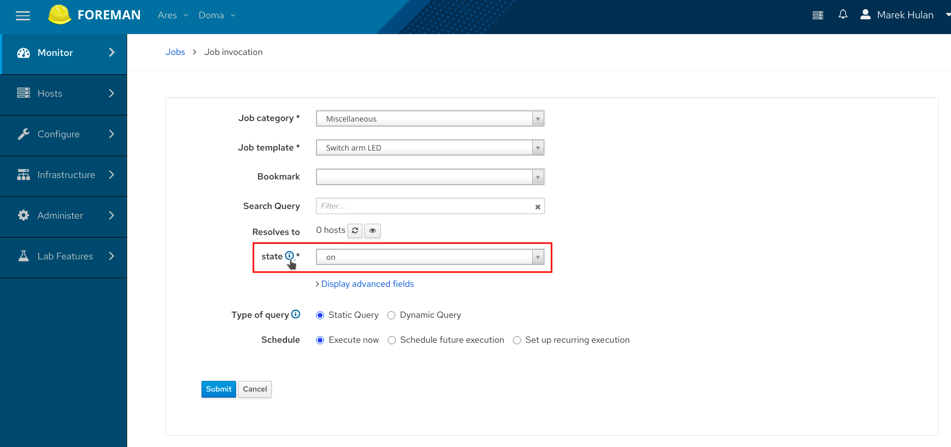

When the job is run from the UI, the state input is presented. The inline help shown after clicking the question mark icon shows the text that’s put in the Template Input description.
