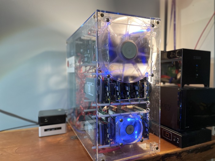

Custom Facts can be anything that we need. In my instance, I have a lab environment that I use for development and demonstrations where I need to keep track of many small systems. The lab contains 17 Intel NUC boards and sometimes I need to know which particular board I am working with. As the discovery_bootif for all my system’s is the onboard NIC and the MAC is printed on the board, this gives me a unique identifier and simple means of tracking these little guys as they are swapped in and out of the environment before I even power them on. I can use the MAC to map to a custom fact that tells me where the system is located in the chassis for the lab. How do we generate the custom fact though?

As you can see, to generate the facts we want, we implement a bit of ruby code that is consumed by facter. This ruby file is tucked under the facts directory. In the example, we simply created a case statement to map the MAC address to the position where the board is installed within the chassis. A simple row and column model like a spreadsheet is used in this example. All the systems connected by risers are a “Stack” and each is positioned from the connecting side. The ruby code looks like this:

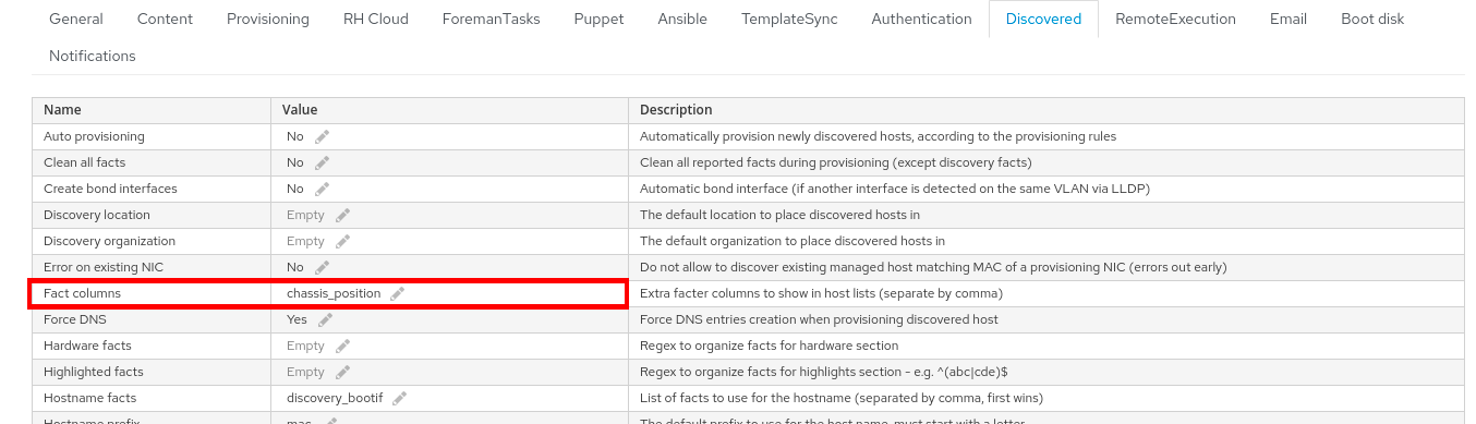

You can display the new fact in the Foreman web UI by editing the Discovered settings under Administer > Settings > Discovered. Add your custom facts to display to the Fact columns entry. This can be a comma-separated list if you have multiple facts. Also, you may want to make use of that new custom fact in generating the default hostname for the discovered system. You can edit the Hostname fact and Hostname prefix entries to change Foreman Discovery’s hostname generation scheme. If there are any spaces (or other disallowed hostname characters) in your Custom Fact, they are removed to create the hostname and all characters are converted to lowercase. Click Submit.

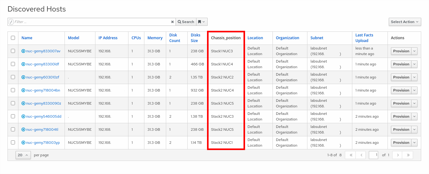

After rebooting several of your discovered hosts, you should see the new fact displayed. If a system didn’t generate the fact, you will see N/A in the column - that would signal something to investigate.
