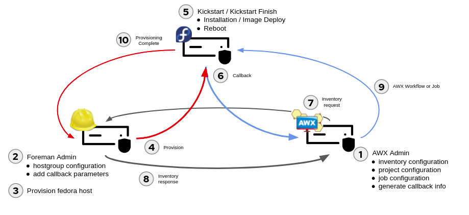

Here is a quick overview of the steps that occur during provisioning with Ansible Callbacks. It involves the proper configuration of the AWX and Foreman Servers and coordinated communication between AWX, Foreman and the provisioned client. The communications take place over configured HTTPS ports and SSH ports.

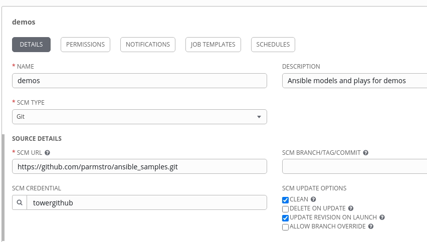

Clone the repo listed above to your own git repository, local or on your favourite git instance. Create a new project in AWX, give it a name - ‘demo’ in our case - and set the SCM type to git. Enter the URL of your cloned copy of the repo and set the credentials. I like to start with a clean copy and update on launch whenever I am developing or using demo code. Select your source code controls appropriately for your environment. It is assumed that you have done this before in AWX and already have configured credentials to login to your repos. To understand more, see the Projects and Credentials documentation.

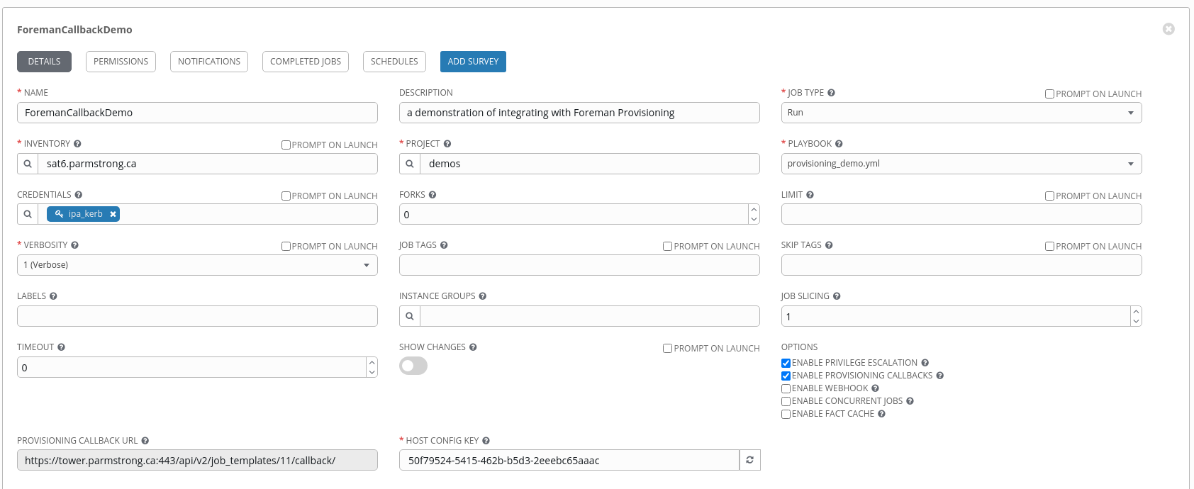

Use the first image for a general overview of how to configure AWX to interact with Foreman.
  • In your AWX instance, navigate to the templates page and create a new job template. Here, we will add the information for our play and generate the key to use with the callback.
  • Provide a name and optional description.
  • Select job type of Run.
  • Select an inventory - for Foreman integration we use an inventory with a Source type of Red Hat Satellite 6 pointing to our Foreman server.
  • Select the project you created in the previous section. I have created a project that I pull down from github called demos, you can use a local project or any other project that your AWX system has access to.

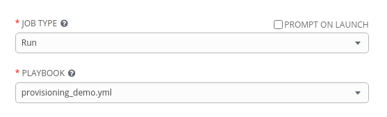

  • Select your playbook from the available plays in your project.
  • Select your credentials that Ansible will use to connect to the newly provisioned machine. In this instance, I have used a set of default credentials that match the initial root password configured for the hostgroup in Foreman. Ensure that you select the appropriate options for the job as highlighted in the screenshot.

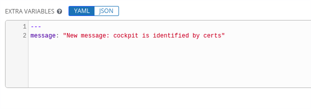

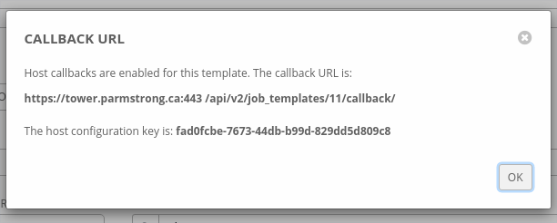

  • The ENABLE PROVISIONING CALLBACKS option, when selected, will display the HOST CONFIG KEY field and you can generate a new key by clicking on the regeneration button to the right of the field. You can add or override variables in the EXTRA VARIABLES field. Try adding an override of the message value for the banner here.
The variable name is simply “message”.
  • Save the Job Template.
When the job template is saved, AWX generates and displays the information that we need and allows us to copy it to Foreman. The template ID is the second last element in the callback URL. In this case the number 11. The host configuration key is also repeated for us.
